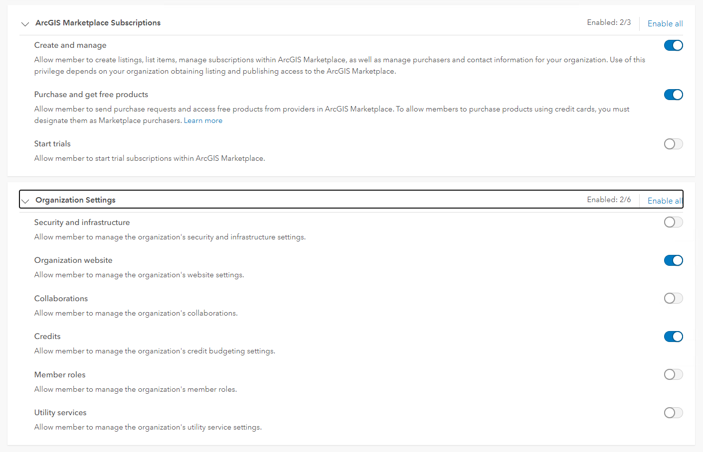

I have a situation where I have a pseudo administration role that is not an administrator to meet certain internal organization needs.  After the last AGOL update, that role no longer is able to change the sharing settings on an item that is not owned by them, even though they have the rights to be able to do so. The only permissions I left out were the following:
Everything else they can do.
