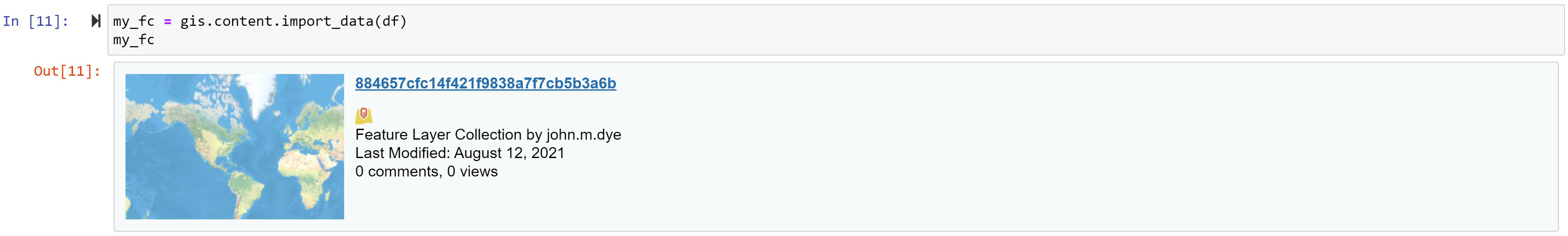

In my python notebook, I create a Feature Layer from a spatial dataframe already populated with x/y coordinates and attributes using:

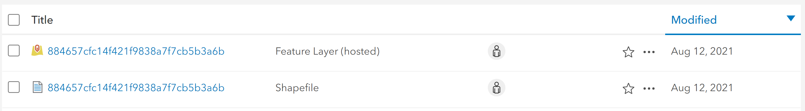

 which produces a Feature Layer Collection. All is good. But then I look in My Content in my organization and the item type is shown as Feature Layer (hosted).
So which is it? A Hosted Feature Layer or a Feature Layer Collection? Am I going to be charged 2.4 credits per 10MB/month or 1.2 credits per 1GB/month for my Feature Layer Collection/Feature Layer (hosted) item.
OR am I thinking about Feature Collections wrong and the Feature Layer collection is actually the Shapefile that was generated, which the Feature Layer (hosted) was then created from and the Shapefile is what costs 1.2 credits per 1GB/month while the Feature Layer (hosted) costs 2/4 credits per 10MB/month.

In the context of ArcGIS Online, the terms "feature layer (hosted)" and "feature layer collection" are equivalent. The former is typically used in user-facing contexts, like the documentation and user-interface, while the latter usually appears in systems administration and programmatic contexts. Both are generally synonymous with "feature service" too.
A "feature collection" is different. It is a sub-type of "feature layer", supporting a specific, limited set of functionality (see Feature collections.)  For example, when you save a route from Map Viewer, it is stored as a "feature collection", and in the Online interfaced, it is listed as a "Route layer" with a source of "Feature collection".
