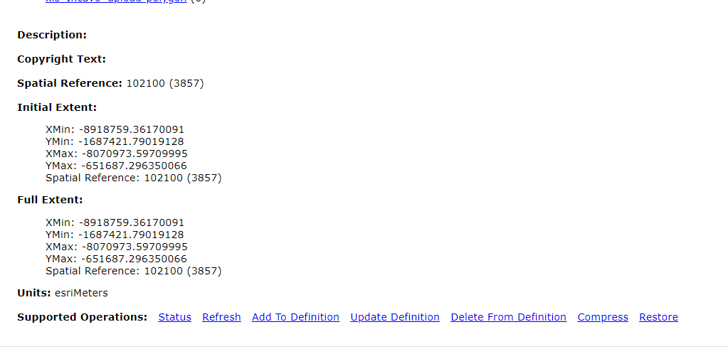

I have tried to correct this in the ArcGIS REST Services Directory --> Admin --> Update Definition:AnnekeBouman_0-1711729921615.png
by editing:
          "name" : "Hectares",
          "type" : "esriFieldTypeDouble",
          "actualType" : "float",
          "alias" : "Hectares",
          "sqlType" : "sqlTypeFloat",
          "nullable" : true,
          "editable" : true,
          "visible" : true,
          "domain" : null,
          "defaultValue" : null
but even though the changes seem to get accepted, and I refreshed the page, they are not visible in Map Viewer.

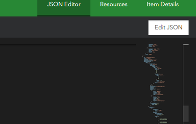

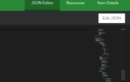

Second option I have tried:
I have also tried ArcGIS Assistant, by View Item JSON --> Edit JSON, but this also didn't update the changes in Map Viewer.

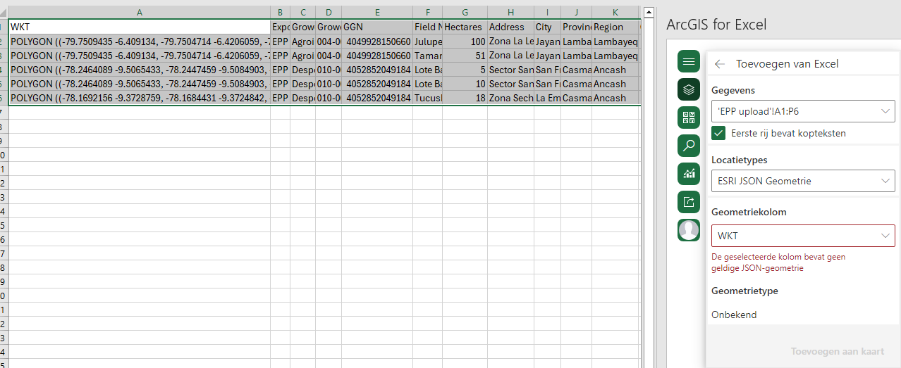

The fourth and final option I have tried:
I have tried the add-in ArcGIS for Excel. When I choose lat/long as coordinates, it will create a point, and I want the polygon data from column A to be used. But when I choose ESRI JSON Geometry, it does not recognize WKT as the geometry column.
