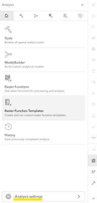

Have you tried looking at the Analysis settings in Map Viewer? To confirm, open the Analysis pane >> click on Analysis settings, to check the Crediting section.
Do you happen to have the option to Apply credit threshold enabled?

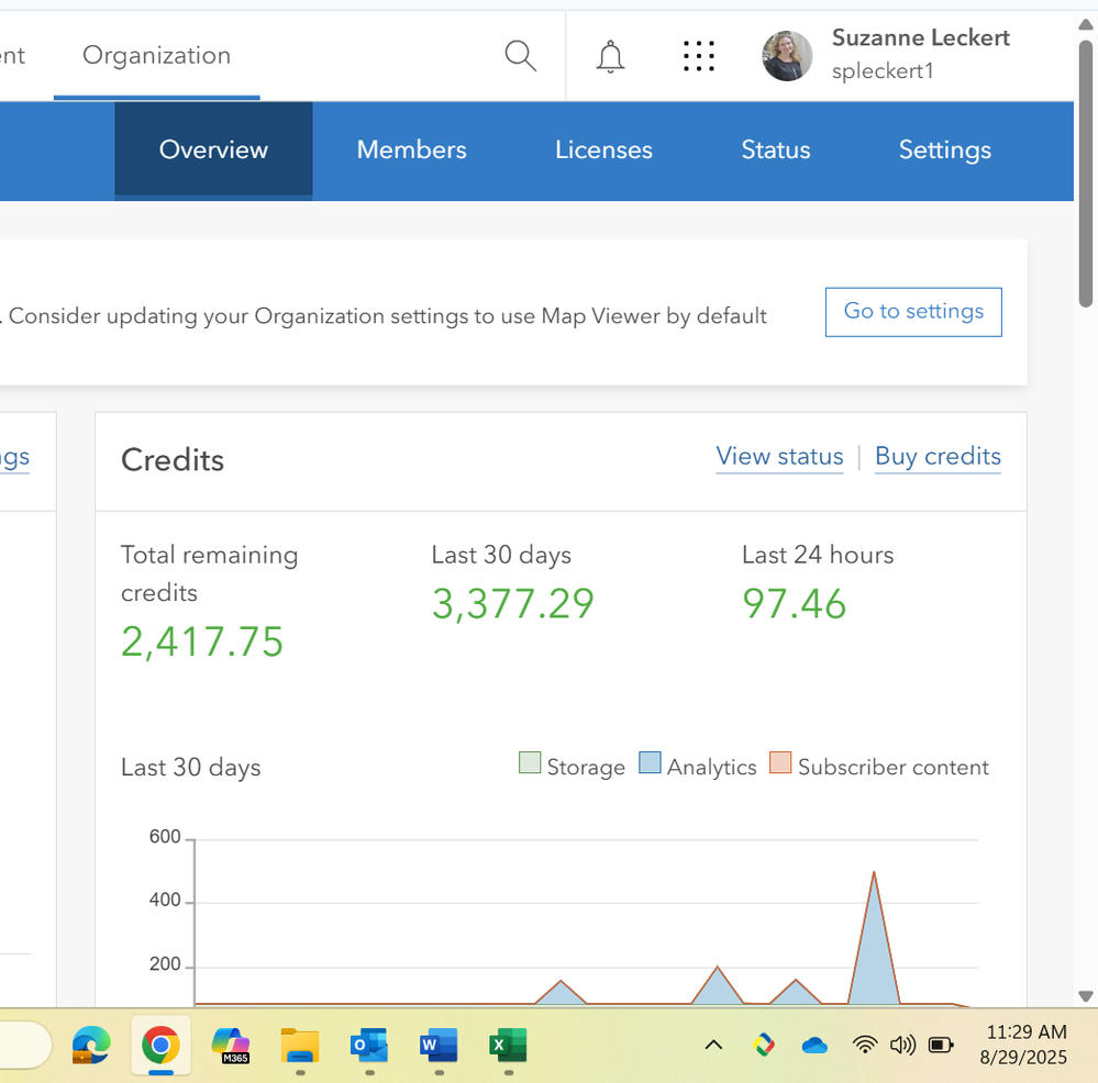

Can you provide a screenshot of your org's AGOL opening screen that shows the current credit status?
SuzanneLeckert
