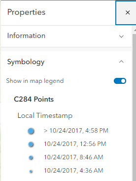

EmilyGeo
Hi @geomatique_devvs
You can toggle to display layers in the legend inside of the Properties panel for the layer.
  1. Select the Layer
  2. Click to open Properties
  3. Toggle the switch next to 'Show in Map Legend'
