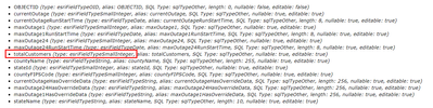

@LindaSlattery you should not need the params = {'f':'pjson'}.  The issue appears to be the type of field for totalCustomers.  This is set to Small Integer:
This data type is limited to only a small range of values.  I would recommend converting all fields from Small Integer to Long Integer, then republish the feature service.

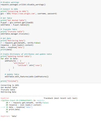

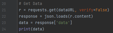

ArmstKP
@LindaSlattery
Thank you Linda for your example.  I have a question for you.  I used your example and receive this error.  Would you happen to know why?
