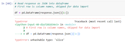

LindaSlattery
I'm getting hung up on the following line: I've tried replacing the 1: with the variable name and even taking it out altogether, but then I get different errors. Any idea how to get past that?
