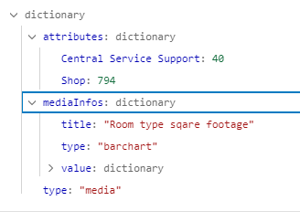

Hi,
I am trying to add charts to my popups and was able to get the result from the image below:
but in my popup the chart just kept loading and refused to show up at all:
I'd appreciate it if anyone could shed some light on what I did wrong. Thanks.
Here is my Arcade expression:
var a = FeatureSetByName($datastore, 'Data', ['Bldg_Num', 'Room_Type_Description', 'ASF'])
var bn = $feature.BuildingNumber
var v = Filter(a, 'Bldg_Num=@bn')
var stats = GroupBy(v, 'Room_Type_Description', {name: 'Area', expression: 'ASF', statistic: 'SUM'})
var allSpcTP = OrderBy(stats, 'Area')
var Values = {}
var pieNames = []
for (var i in allSpcTP){
  Values[i.Room_Type_Description]= Number(i.Area);
  Push(pieNames, i.Room_Type_Description)
return {
  type: "media",
  attributes:Values,
  mediaInfos:{
    type: "barchart",
    title: 'Room type sqare footage',
    value: {
      fields: pieNames
Tags (3)
JohnEvans6
I think its that mediaInfos should be an array since you can have multiple charts:
return {
  type: "media",
  attributes:Values,
  mediaInfos:[{
    type: "barchart",
    value: {
      fields: pieNames
JohnEvans6
return {
  type: "media",
  attributes:Values,
  mediaInfos:[{
    type: "barchart",
    value: {
      fields: pieNames
ZhongmingAn
Thank you! It works.
You just saved me from insanity...
