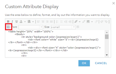

It is possible to configure pop-ups using a combination of HTML and arcade. You create your expressions in arcade, and then use the configure pop-up button to format the pop-up using HTML.  Once you've opened the configure pop-up dialog window (Figure 1), there is a toggle button that allows you to toggle between the standard interface and HTML (Figure 2).
Figure 1: Shows the green configure button on the configure pop-up panel.
Figure 2: Shows the HTML interface and the toggle button (marked by red outline in this image).
I used a custom script to change the colour of font or background and called this script in the example above, using expression 1 in the example above.
