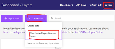

Once on the developer site with an account, you can create a hosted feature layer by going to the Layers section, then + Create data and choosing the New hosted layer (Feature layer) option. The page will then walk you through creating a new hosted feature layer.
