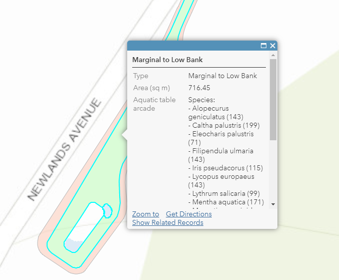

I am trying to create a customised pop-up in AGOL for a web layer I have uploaded that has a related table (text only).
Polygon table structure is:
GlobalID (GUID)
Area (shape_area)
Length (shape_length)
Related table structure
GID1 (GUID) - this is the related key back to the parent polygon table
Type (text)
Number (short)
Phase (text)
Right now I can click on "show related records" in the pop-up, but ideally I would like this information to be displayed in the pop-up and not in a separate table below the map.
I tried doing some simple arcade programming and got the expression result to work using this:
FeatureSetByRelationshipName($feature,"native_plantin_rel_table",["Type","Number","Phase"])
But when I implement this in the popup, it does not work and only get "No information available" message in the popup
Any ideas?

Hi Jeff Van Etten ,
When you use an expression like you did, this will return a featureset, which will show when you test the expression in the editor, but this will not show in the pop-up. You will have to loop through the records in the featureset and define how to present them in the pop-up.
You can find some examples here: https://community.esri.com/message/900835-show-all-related-or-joined-attributes-in-a-popup

Jeff_VanEtten
Xander
Have looked at the link and I can test the arcade script and it works, but when I try to use this, nothing is coming up.  Here is my arcade script.
var aquatic_id = $feature["GlobalID"];
var aquatic_tbl = FeatureSetByName($map,"aquatic table");
var sql = "GID1 = '" + aquatic_id + "'";
var aquatics = Filter(aquatic_tbl, sql);
var cnt = Count(aquatics);
var result = "Species: ";
if (cnt > 0) {
for (var aquatic in aquatics) {
result += TextFormatting.NewLine + " - " + aquatic.Type + " (" + aquatic.Number + ")";
} else {
result += TextFormatting.NewLine + " - No species present";
return result;
Just closed the map viewer and opened this back up and it now works!  Fantastic!
