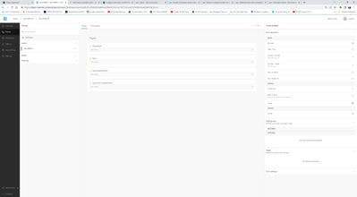

Hi All, I was wondering if someone would be able to help.
I've setup a feature layer within ARCGIS Pro and added contingent values for two fields but when I upload the layer to ARCGIS Online it doesn't seem to have imported the contingent values across. Is this something that ARCGIS Online doesn't support or is there something obvious that I'm missing!
Any help or advice would be much appreciated.
Thanks
Sietse_de_Haan
Hey there,
S I also had this issue at first. But I figured out that in Field Maps Editor youcan't just convert the popup, or at least the fields that are part of the contingent values.
On the side you have a space where the fields are shown and you can drag them into the form. A yellow symbol shows that it is part of Field Group.
Hope this helps!
