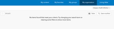

Don't know if there is a quick fix for this but for some reason a few of my content (a webmap and a dashboard) is not showing up into the categories that I have put them in. This is only the case for only two of my categories. All the content within the category is shared publicly. It is showing up next to the category when editing the categories but again not when searching for it within my content or my organization. Is there an easy fix to this or something I'm not noticing?
Stephanie_F
Hi @DevinPancake I just tested this in my own subscription and believe the issue is the "&" in your category title. When you configure item categories from the Organization Settings an error flags indicating that the character is not allowed in the category title. The "&" can be added if you manage categories from the Content tab which is logged as BUG-000172279: Configuring item categories from the Content page allows categories to be created with prohibited characters like "&" and results in the category filter not working when used to search content
I suggest updating your category to remove the "&", this should prompt that it will update all associated items with that category, allowing the filter to work correctly.
