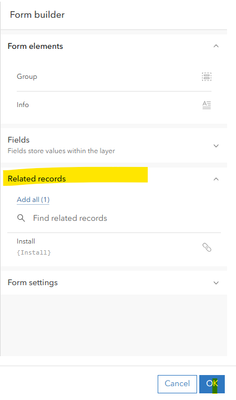

Hi @HaleyBrueckman1
You should be able to see the related record element in the form builder - and add that to the form in order to edit related records.
If you are not able to see the related records element(s) in forms, then I recommend reaching out to support to log a ticket so they can investigate whether there is a bug that has been introduced.
I'm happy to take a look at the layer as well if you are able to share the link.
