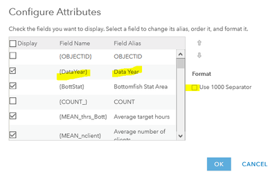

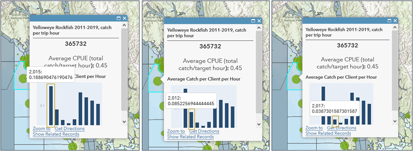

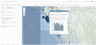

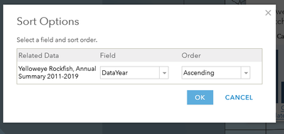

I tried this solution to try and get my related table chart in a pop-up to sort based on data year (which is in numeric format) with no luck. In addition to my sort settings not being honored in the chart, when I hover over columns, my attribute configurations also being ignored (no thousand separator).
Pop-up with related chart:
Related data sort settings from pop-up configuration:
And in terms of the thousands separator being retained from the year in the chart, I would've assumed it would've inherited the related table attribute settings, as pictured, but that isn't happening:
Any help with this would be great. Thank you!!

Sorry for the long delay @Anonymous User, it is now shared with you!

Hi @EmmaHatcher thanks for sharing the map and layers. Apologies for the delay on my side too. This seems to be working as expected for me - did you change any of your configurations?
For the thousands separator formatting, make sure to choose field from your related table rather than the feature layer.
Hope this helps,
