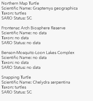

This is what the results look like now:

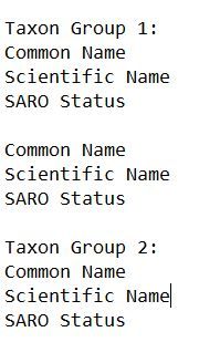

And this is what I'm hoping for them to look:
