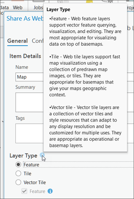

One thing to consider is that you can publish hosted services as three types: feature layers, tile layers and vector tiles. the info button (i) will provide some guidance.
While conventional wisdom in the past may have steered you to tiles for performance, IMHO the best way to go these days is to publish feature layers for your operational layers as you'll have more than "dumb tiles." Vector tile layers would be another good bet if you don't need to interrogate the features as they have advantages over tiles.
If you really want to publish tiles, then you can build tiles for a map document and store them in a tile package (.tpk file). You can share a tile package on ArcGIS Online and publish it as a hosted tile layer. This workflow allows you to build tiles using your own computing power, rather than your ArcGIS Online credits, so is a very economical way to create hosted tile layers if that's what you want to do.
