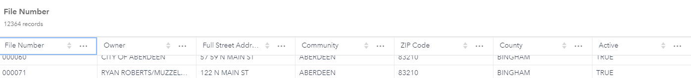

I have a parent feature layer called "File_Number"ColeNelson62077_1-1630429362578.png

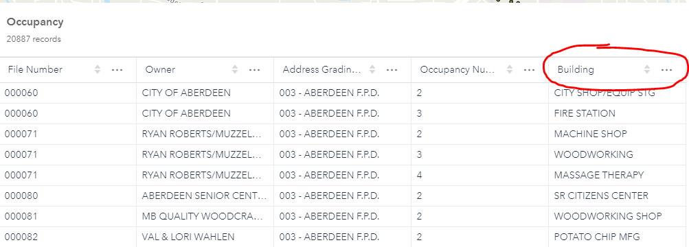

and a child table called "Occupancy"
I've created a 1:M relationship class for them, using their File Number fields in ArcGIS Pro, and then uploaded them to ArcGIS Online.
What I'm trying do is configure the popup for the File Number feature layer to display all of the occupants associated with each file number from the Occupancy table.  The occupants are found in the Building column which I circled in the screenshot.  Here is a code that I found on the internet and  have been currently working with.
