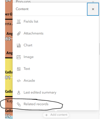

I have the exact same problem.  No way to see the related table in the new Map Viewer.  Online help (Configure pop-ups (Map Viewer)—ArcGIS Online Help | Documentation) for related tables (bottom of page) says to "2. Click Add content and choose Related records.", but it does not show me that option in the new Map Viewer.  I can configure the pop-ups for the related table, but no way to show it or see it in the actual pop-up.  The classic version has a link at the bottom of the pop-up window that allows you to see related records.  Where is this functionality in the new viewer?
KeithLomis1
Have you heard or seen an update on this?
Laura
by MVP Regular Contributor
Did you configure the popup on the parent layer to show the related record?
You should see this on the parent layer.
