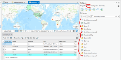

GeeteshSingh07
@MtnRunner, In addition to what Christopher suggested, you can also perform editing this way:
In ArcGIS Pro, sign-in with your ArcGIS Online account.
In ArcGIS Pro, open Catalog Pane >> Click Portal >> Add your feature layer (hosted) or web map.
Perform editing and save the changes.
When saved feature/attribute editing will directly reflect in your ArcGIS Online.
If you need to export data locally, you can add your feature services to map, use "Export Feature" gp tool to save the data locally....You also have the option to 'Publish the layer to ArcGIS Online" or "Overwrite existing layers" in ArcGIS Online through ArcGIS Pro.
