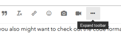

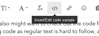

Great! I'll look it over. But you also might want to check out the code formatting options in the extended post toolbar. Pasting code as regular text is hard to follow, and then there's this little thing:
