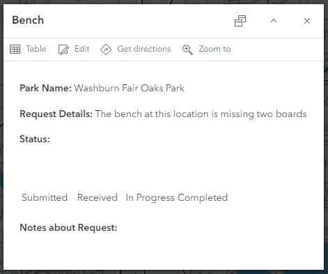

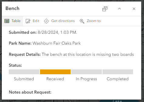

The below code works in both the Classic and New Map Viewers.  But, if I remove the 3rd, 5th, 7th or 9th line of code, the status bar will not render in the New Map Viewer, but will in the Classic.  Why is this?

With no lines removed:
With the 3rd line removed:
<strong>Submitted on:</strong> {created_date}.<br>
Status bar is gone:
