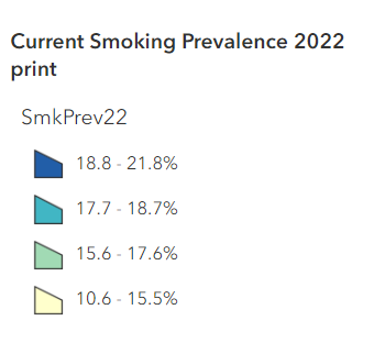

Hi! I'm a new GIS user and struggling with a Web Map on ArcGIS Online. The map is smoking prevalence and I'd like to display the data in quantiles from low to high, but I cannot figure out how to do this. I created a print version in ArcGIS Pro and this is a screen shot of the Symbology:
When I upload the map as a web layer to ArcGIS online, the symbology is reversed and the data is categorized high to low as shown:
I've tried reversing the data range using the "flip ramp" option, but that just changes the colors and I can't figure out how to reverse the data so that it displays from low to high like in the print version.

What you could do is create a quick Arcade expression to multiply your %s by -1 then just type in the ranges you want when configuring the symbology. @BurroughsJ

A million thanks to you, @JonathanMcD !!! This worked ! 😀 Thank you for taking time to help out a stranger. I'm very grateful. Have a wonderful day!
