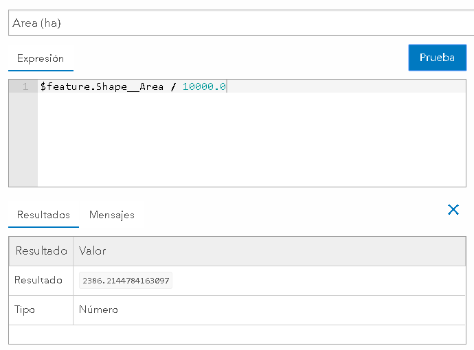

I think the easiest way would be to create an Expression with ArcGIS Arcade | ArcGIS for Developers . Just configure the pop-up and add an expression and as expression enter this:
$feature.Shape__Area / 10000.0
It will show up in the pop-up window
... and attribute table.

JCooley_ClackamasSWCD
This is a bad approach if you want to show the actual area of the polygon.  If you use Shape__Area for the pop-up calculation you will end up with the planar area of the polygon.  Hosted feature layers always use Web Mercator.  This coordinate system does not preserve shapes.  The further you get from the equator the more distorted it gets.  This is usually not even close to the area in the real world.  For example, when you get to 45 degrees latitude the planar area of a polygon is about a 2 times the geodesic area. You can use arcade to calculate the geodesic area for your polygons after adding an additional field to hold the values.  Divide this number by 1,000 to get hectares.
