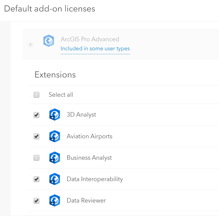

As a university, all our operations for the time have shifted to online, so I've had more students taking advantage of our single-sign on. I'm having an issue though with the default licenses not 'sticking' to them though. Everything is configured how I want it:
But students are reporting back that they don't have any extensions available. These are all students with new SSO accounts- about 19 in total so far.
