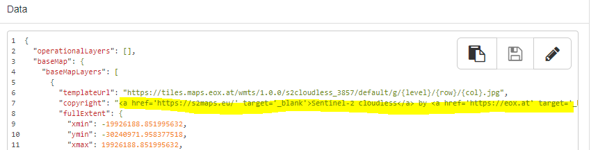

I needed to to this for the Sentinel-2 global cloudless mosaic – EOX  (Check the License chapter on the bottom of the page). The WMTS endpoint combines several other data and has a general information in the <ows:AccessConstraints>-tag of the capabilities: https://tiles.maps.eox.at/wmts/1.0.0/WMTSCapabilities.xml
https://community.esri.com/groups/technical-support says that there is no way for them to modify the attribution of that WMTS. But I found a workaround:
- Login to ArcGIS Online Assistant
- Choose: I want to... "View an Item's JSON"
- Select your (base)map using the external Service
- Scroll down to the "Data" part of the JSON and click the pen to edit
- Write your attribution in the copyright text between the double quotes in the "baseMap"-Section (see screenshot).
- If you add a <a>-tag, use single quotes for the URL
- Save
- Refresh the Web Map and the changes are reflected.
Note: If you have already other web maps using that base map, you need to edit their json manually as well. They are not updated automatically.
