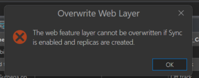

Hi, can anyone offer any advice?
Attempting to overwrite a layer in ArcGIS Online from ArcGIS Pro (it needs to be updated weekley)
  • Get warning that layers that sync is enabled, and I have replicas created.

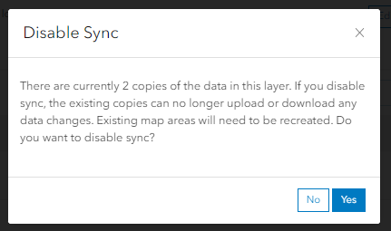

  • If I attempt to turn off sync I get this warning
  • This has just started happening because I've been trying to build a Field Map App with offline ability using these layers. I have a new webmap with these layers specifically for the app.
Can anyone offer any advice?

@Hels77,
Instead of overwriting, try performing a truncate/append of the service:
https://community.esri.com/t5/arcgis-online-documents/overwrite-arcgis-online-feature-service-using/...
In the above python script, you can set the disableSync variable to False.
