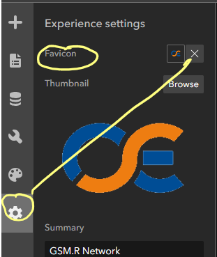

ThanosDoganis
In the settings panel (left side) you can add or change it. I 've done it in EXB 1.18 developer edition.
