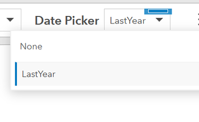

Unfortunately, you can't get Arcade to work like that in the dashboard. A date selector is "layer agnostic", so to speak, and can't work with non-attribute data, as it is essentially just submitting an SQL query to the feature service.
If you watch the network traffic on your browser, you can see it happen:
Picking that option sends this to request (relevant part bolded):
{"GET":
"scheme":"https",
"host":"services6.arcgis.com",
"filename":"/U1zX3Wx8hhY7Gb30/arcgis/rest/services/Sales_Hosted/FeatureServer/0/query",
"query":{
"f":"json",
"cacheHint":"true",
"groupByFieldsForStatistics":"sale_year,valid_sale",
"orderByFields":"sale_year ASC",
"outFields":"*",
"outStatistics":"[{\"onStatisticField\":\"id\",\"outStatisticFieldName\":\"value\",\"statisticType\":\"count\"}]",
"resultType":"standard",
"returnGeometry":"false",
"spatialRel":"esriSpatialRelIntersects",
"where":"(sale_date>timestamp '2006-01-02 05:59:59' AND valid_sale=0) AND (sale_date BETWEEN timestamp '2020-01-01 06:00:00' AND timestamp '2021-01-01 05:59:59')"
The only way to get a date filter to work would be to create a true date field. You wouldn't be the first person to create a new field for the sake of a dashboard!
