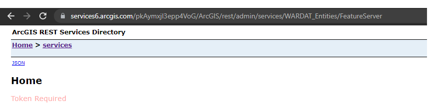

However when I get to the part that says:
  1. In the browser's address bar, insert 'admin' between 'rest' and 'services' in the URL like the one displayed below:
It takes me to a page that just says Token Required
What am I doing wrong?

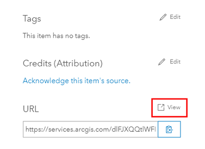

Hi @JamesMcClellan ,
Try the following:
1.  Log into ArcGIS Online
2.  Go to the item details of the service you wish to update
3.  Click View at the bottom of the page:
This should add the URL with a token to a new tab.
5.  Add the admin portion into the URL.

JamesMcClellan
Thanks! That did the trick!
