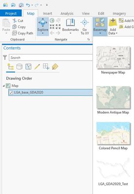

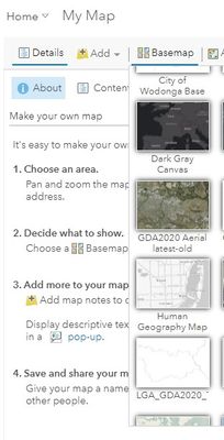

Hi Zara,
I am trying to switch basemaps between GDA2020Zone55 EPSG:7855 and WGS84.
One example web map we are using as basemap:
LGA_GDA2020_Test - Overview (arcgis.com)
Interestingly, this basemap is showing on both ArcGIS Pro and MapViewer Classic but not MapViewer.
   We also have other web map basemaps that contain this layer and WMS tile service in GDA2020, but cannot switch on the MapViewer.

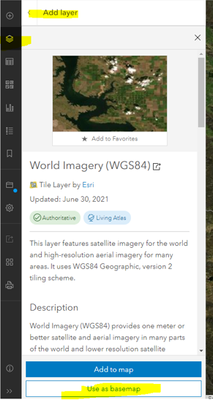

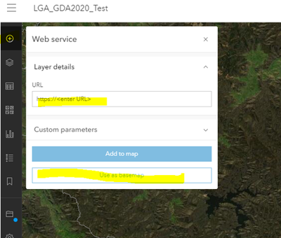

Thanks Brandon,
It is currently a known limitation that you can’t  switch between basemaps with different spatial references from the basemap gallery (those with a different SR from your map will be greyed out). However,  you can still change the basemap to a basemap with a different SR in other ways.
From Add Data > Web Service > Enter the URL of your basemap layer and select “Use as Basemap”
From the Layers Pane > Add Layer > Search for  a layer and select “Use as Basemap”
I tested switching from your basemap to some WGS84 basemaps this way and it worked for me. Hope this helps.
BrandonGuo
Thanks Zara, it works this way. Hopefully switch from the basemap gallery will come to the new MapViewer soon.
