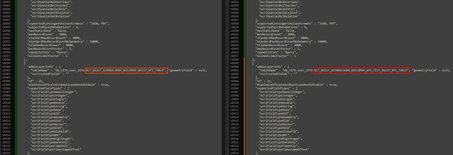

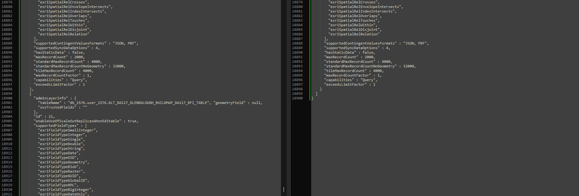

I then performed some tests. I aimed to get the JSON section of the table I want to add by publishing two versions of the same feature layer from ArcGIS Pro: One with the table (first feature layer), and one without the table (second feature layer). I then extracted the JSON definition from both sources and compared them on Notepad++. The differences started indeed at the end of the second feature layer as we can see by this snippet:
What I did then was to append the "Table" section of the JSON definition to the second one by ensuring that it was perfectly matching the first JSON. I only had to change the "tablename" argument to match with the second feature layer's name as follows:

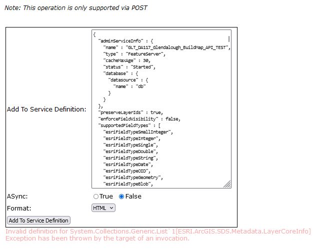

I then went back to the REST Services Directory of the second feature layer and tried to use the "Add to Definition". What I replaced to the JSON definition was basically the exact definition of the first feature layer, so I was expecting for it to work, but unfortunately it did not and this error message was pulled:
Invalid definition for System.Collections.Generic.List`1[ESRI.ArcGIS.SDS.Metadata.LayerCoreInfo]
Exception has been thrown by the target of an invocation.
