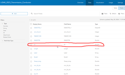

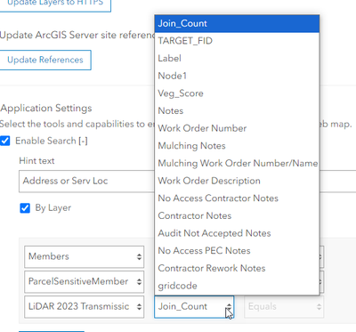

Hello. I am trying to set up the Search by Layers feature within a webmap in ArcGIS Online. I am not able to see one of the fields I am trying to set up. Is there something that needs to be configured for each field in order for it to be able to be searched? This thread https://community.esri.com/t5/arcgis-online-questions/cannot-search-multiple-fields-for-hosted-featu... has a similar issue so wondering if this is just another bug.
Field not seen in dropdown below

The field type needs to be integer or string. Domains also cannot be used on the fields.
https://doc.arcgis.com/en/arcgis-online/create-maps/configure-feature-search.htm
