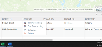

in Map Viewer Classic, open the table and left click on the column header.  Select Calculate from the popup and then choose from one of the functions on the right.
Matt-Huser
I don't think I'm seeing what you are.  I don't have any options like that. Arcade fields are locked and existing schema fields don't have a calculate options.

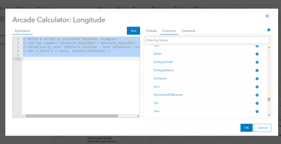

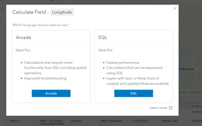

by Anonymous User
Not applicable
you obviously won't sum Longitude but this is the idea and how it appears for me
Matt-Huser
Thanks for the screenshots this was helpful for me to explore into.  This appears to be for only hosted data layers.  Also I think this is AGOL's version of Field Calculator which you wouldn't be able to run on a field created using an Arcade Expressions.
