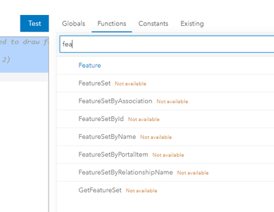

Are you trying to do this as like an attribute rule or just for display in the popup?  I assumed popup.  Have not used rules much but I would think you would need to test for null.  But then I do not know if it would ever populate after the fact.  Popup should be enough I think?
TravisSizemore
I was trying to do it as an attribute rule within Field Maps, but maybe if that's not possible I could do something with the popup. The only real use of this field is to change the symbology within the mobile map so they can see where they need to retrieve remaining devices. Perhaps the same expression within the symbology settings would work.
DougBrowning
MVP Esteemed Contributor
I was afraid you would say that.  Sorry but cant use FeatureSet functions for symbols.  Too slow I guess.  Pop up only.  It is a huge drawback for sure.  If you want symbols has to be a real field.  Then its back to old school run a script on a schedule.  Not sure this will ever change?  It could be super duper slow.
