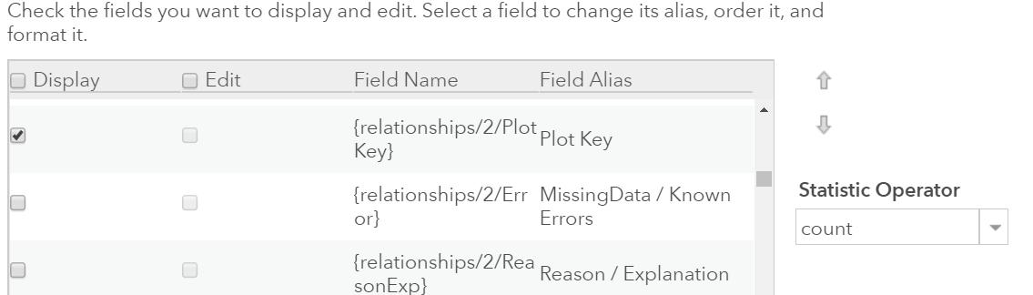

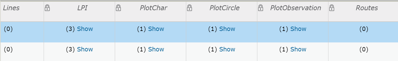

In a web map the Attribute table will show you how many related records there are for each Relationship Class.
Like this
Is there any way I can get\use this number?  Any way to use it to symbolize?  Sort by?
    For example I want to be able to tell the user they only have 2 LPI forms when it should be 3.  AKA how can the user get a list of features that were not fully completed.

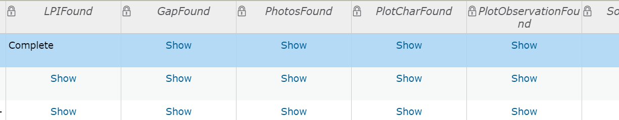

In Arcade I can do a check using FeatureSetByName but then I again cannot symbolize or filter.  Plus the user would have to click show a thousand times in the attribute table.  (The word Complete is where I clicked)

The second image sample shown is using Arcade.  But it will not let me filter, sort, of even just show the values.  You must click on Show for every single record.
A join would be static so I would have to remake it everyday.
