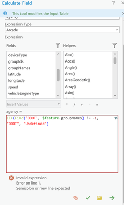

I tried using your expression from line 1 as a test and received the error message below.

JoshLay1
Thanks Ken and Cody that worked! ESRI Community is awesome!
