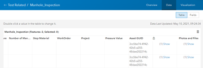

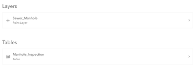

Hi @HermanLouie1 - when you use the manhole inspections template, attachments are enabled by default on the related table (Manhole_Inspection). ArcGIS Online creates and manages the attachments table behind the scenes. If you select the table from the page you're on in your screenshot, you will see the "Enable Attachments" option on the right side of the table's details page.
If you go to add an inspection in the field, you will have the option to include a photo.
You can also create a standalone table with attachments by creating a feature layer from the Content page (Content > Create > Feature Layer > Build a Layer > Table ) then enabling attachments in the same way as described above.
