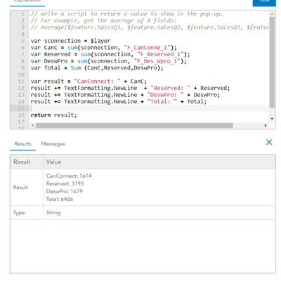

aroininen
It doesn't seam to use the filter...? did I miss something...?
var sql = "ServiceAre_1 IN (2,5,6,8,9)";
var fs = Filter ($layer,sql);
var sconnection = $layer
var CanC = sum(sconnection, "F_CanConne_1");
var Reserved = sum(sconnection, "F_Reserved_1");
var DeswPro = sum(sconnection, "F_Des_Wpro_1");
var Total = Canc + Reserved + DeswPro;
var result = "CanConnect: " + CanC;
result += TextFormatting.NewLine + "Reserved: " + Reserved;
result += TextFormatting.NewLine + "DeswPro: " + DeswPro;
result += TextFormatting.NewLine + "Total: " + Total;
return result;
CanConnect: 1614
Reserved: 3193
DeswPro: 1679
Total: 6486
XanderBakker
Esri Esteemed Contributor
Hi @aroininen ,
If you look at my code you will see that the Sum is using "fs" (the filtered featureset) and not "sconnection" (the $layer). This is why it is not working for you.
aroininen
awe yes.. thankyou!
