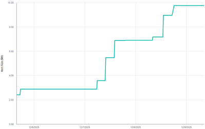

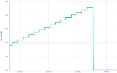

I was aware of the truncate method within the FeatureLayerManager and was hesitant to use it due to its restrictions, outlined here. However, I did change one of our scripts to use this rather than FeatureLayer.delete_features to see if it provided any change. And...it seems to have done the job!
I made the change to this script around 11:30AM, and by about 1PM the feature layer showed a substantial reduction in item size, see first graph below. The item size looks to have remained consistent since making the change to use FeatureLayerManager.truncate.
In the second graph below is one of our hosted feature layers that's still using FeatureLayer.delete_features. You can see this feature layer continues to grow in item size.
I won't speculate on what's being done behind the scenes by Esri, but it does seem that using the truncate method flushes/resets/removes something that the delete_features method is not.
Example 1: Hosted feature layer changed to using FeatureLayerManager.truncate at around 11:30AM on 12/8/2025. Substantial drop in item size noticed around 1PM and item size looks to remain consistent.
Example 2: Hosted feature layer still using FeatureLayer.delete_features and the item size continues to grow.

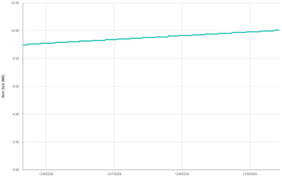

I can see scenarios where you may just want to delete certain features using a where clause. For example, we have a hosted feature layer that stores point-in-time data and has data written to it every 5 minutes. Once the data is written, it's not going to change, so there's not really a point in deleting all rows and replacing them. However, at some point we do want to trim the data within the feature layer, so we use delete_features to delete those feature older than a certain date. The graph below shows the item size for thisparticular feature layer. It's still growing over time, but at a much slower rate...possibly (likely?) because we aren't removing ALL features when it's updated, but rather deleting features once a day based on the date value.
If you're going to be replacing ALL features within a hosted feature layer, I think this makes the case to use truncate over delete_features.
