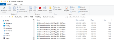

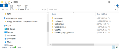

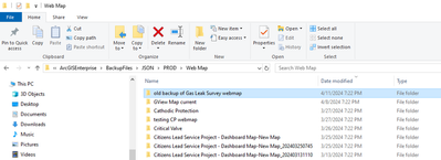

JSON backups
Similarly, I also backup the content JSON files incase schema on a hosted layer gets changed or a webmap/dashboard/app gets inadvertently changed or broken.
ESRI webmaps, dashboards, etc. have two parts to their JSON data.
  • Description
  • Data
The Data is where all the customizations you’ve made to the content are stored.
The script is set to download all the following JSON Data for the following item types in your Portal:
  • Web Map
  • Web Mapping Application
  • Feature Layer
  • Application
  • Dashboard
  • Web Experience
  • item_types
If a new item of that type is added to Portal, a new folder is created from the item name.
If the content was modified in the last 24 hours, a new JSON file is saved.

HanliePetoors
@Tom_Laue thanks for sharing this script.
What would be the process to restore the content if needs be?
Thanks
Hanlie
Tom_Laue
Regular Contributor
Hi Hanlie,

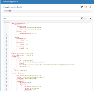

As far as restoring an item from JSON if you accidentally deleted it or if I just want to compare the current vs backed-up item, I create a brand new webmap or dashboard manually in Chrome and copy/pasted the JSON from the backup and overwritten the existing JSON using https://ago-assistant.esri.com/.  Problem with that is you'd get a new item ID which could break other things like scripts or links you'd already established.
I've used the script mostly to:
  1. See what items in my ORG were changed when and have a log each day to refer back to or to restore back to
  2. If an item really got screwed up, I would go into AGO Assistant and replace the json with the backup json and see if that fixed the item.
I go in AGO Assistant.  I search for the item (by default it only display items you own) by name or itemID.
Find the item and in the dropdown choose I want to...View an Item's JSON
Replace the Data of it's json with the .json file you have backed up on your network.
Hit save and then view that item in Chrome or Field Maps.
