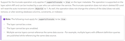

There are some limitations to the FeatureLayerManager.truncate method, which are shown below (REST docs found here), one of them being sync enabled feature layers.

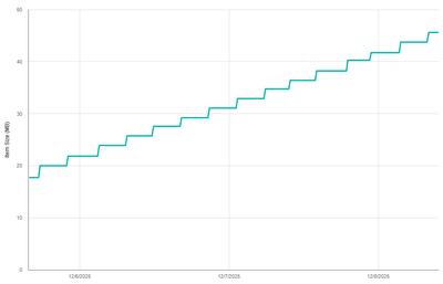

Example 1: This feature layer is updated every 30 minutes using delete/add features. On Friday afternoon the size of the feature layer was about 17-18MB. It is now showing about 45MB.
The number of features and populated fields in this feature layer remains relatively consistent.

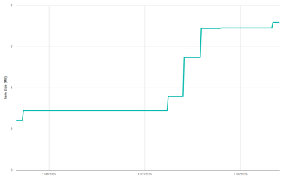

Example 2: This feature layer is updated every 2 minutes using delete/add features. On Friday afternoon the size of the feature layer was about 2MB. It is now showing about 7MB.
The number of features in this feature layer does oscillate but is likely never above 40 features.

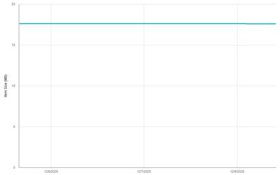

Example 3: This feature layer is updated once a day by publishing a file geodatabase. The size remains consistent.

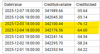

Example 4: Below is snapshot of our available credits near the end of the day for the past few days (the DateValue field is set to noon UTC for our time zone).  The "CreditsUsed" field is calculated from the previous day's value.
We first noticed one of our hosted feature layers ballooning in size on Friday, 12/5/2025.  Once we noticed it, I changed this feature layer to be updated via publishing a file geodatabase.
You can see the noticeable bump in credit usage on Thursday, 12/4, and Friday, 12/5.  Once the feature layer in question was changed to be updated via a file geodatabase, the credit usage remained steady on Saturday, 12/6 and Sunday, 12/7.
