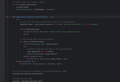

To download Service Definitions the section would look something like this:
I need to update this script to Retry if one fails to download.
