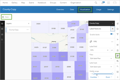

Here's some more details to support what @RussRoberts explains above:
On the item page of the feature layer, click the Visualization tab. Set up labels for the layer. Click Save.
Now, when people add this layer to a map, it will already be labeled.
