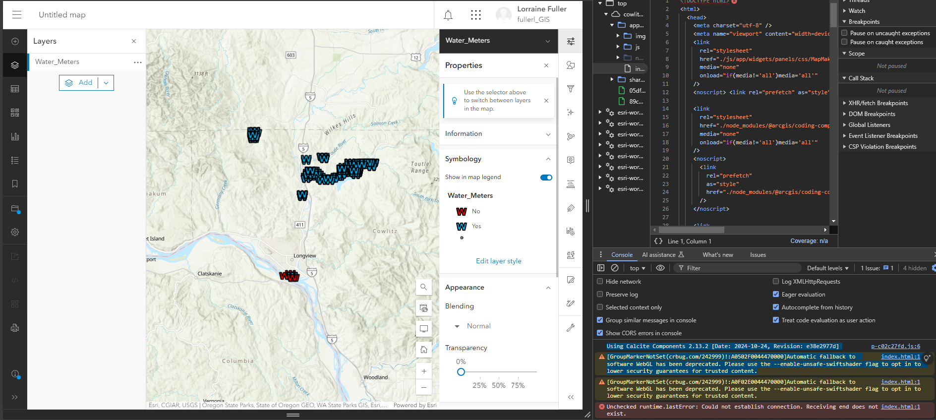

I am working on recreating all of my web maps in experience builder. I was using Map Viewer Classic and Web App builder.
When I open a map in map viewer classic is loads okay. When I make a copy of the map and open it in the new map viewer the screen tiling is very slow and there is alot of lag visible in the screen.  I thought maybe my map had alot of content, so I created a new map with only one point feature class that only contains about 1,200 points so it is a small dataset. It still renders very slowly.
I am working in google chrome and right clicked and clicked inspect and I saw this message in the console. Could this be the issue? I am not a developer at all and don't even know what this means.
Using Calcite Components 2.13.2 [Date: 2024-10-24, Revision: e38e2977d]
index.html:1 [GroupMarkerNotSet(crbug.com/242999)!:A0502F0044470000]Automatic fallback to software WebGL has been deprecated. Please use the --enable-unsafe-swiftshader flag to opt in to lower security guarantees for trusted content.
I attached a video showing how slow it is. I don't know how to fix this.

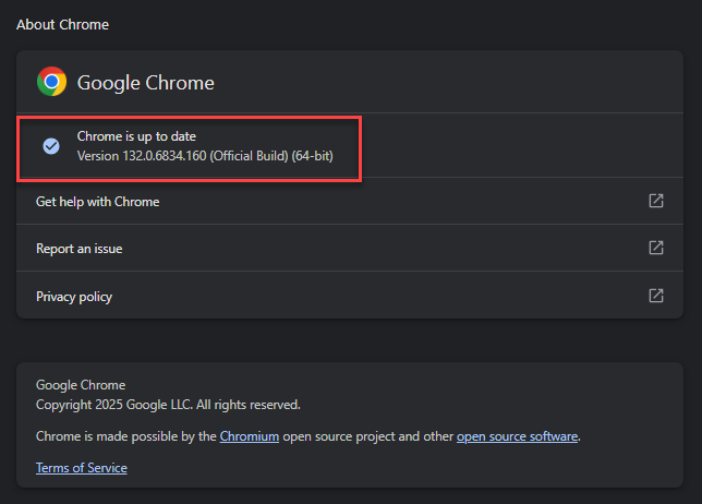

I'm on the same version of Chrome and I can't get the AGOL Map Viewer to trigger that error. More concerningly, the bug referenced in that message has been fixed a decade ago. Try some other maps (even if it's jsut a basemap) and try using other computers, I have a feeling your old Quadro is bugging out a bit.

@L77 @DavidSolari  Pascal based GPUs are still well supported by Nvidia so other than making sure it is stable and you have updated drivers it will be fine.
ArcGIS Pro specs have nothing to do with AGOL performance so stay out of that rabbit hole 😉
(granted there is some overlap but you shouldn't need a 5090 to run New Map Viewer reliably)...
Deprecated does not necessarily mean unsupported (well, it can; but shouldn't be implied for things like this)
As many of us are experiencing bad performance in New Map Viewer in a variety of browsers have a look at the measurement ideas that are mentioned in the other post you linked this one to.
Layer complexity and layer source publication settings seems to drive this - and the point of  impact bar was seemingly set much lower than in Classic Map Viewer.
Please continue the conversation in the other post where more people are involved already. If you can, share the layer sources - especially if they are public open data sources like the services I mentioned in one of my posts.
