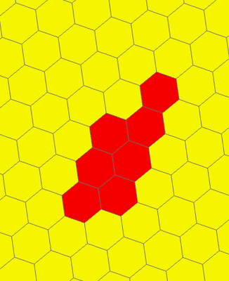

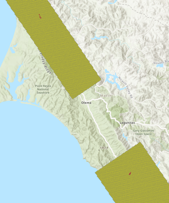

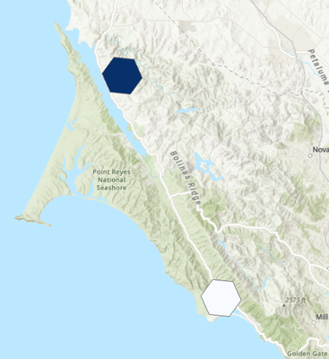

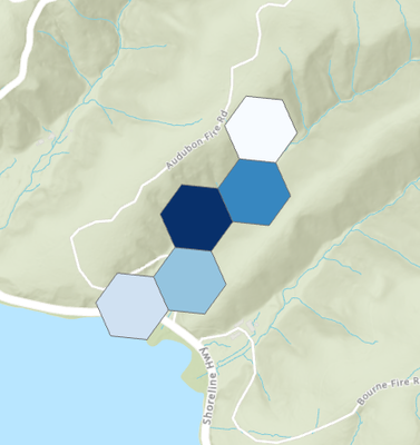

For Example:
Image #1 shows a point layer being aggregated into hexagons. I am totally zoomed out in this imagine. Image #2 shows what happens when I zoom into  Image #1. This is what I hope to apply to my hexagon grid, which is in Image #3 and #4.
Image #1 (zoomed out binned point layer)
Image #2 (zoomed in binned point layer)
Image #3 (zoomed out hexagon grid)
Image #4 (zoomed in hexagon grid)
As you can see, the zoomed-out hexagon grid in Image #3 isn't as very helpful. I want the hexagons to not stay microscopic, but to merge together to show general symbolized hexagons, and then when you zoom in, you get more detailed hexagons/information.

RussRoberts
Esri Notable Contributor
Currently our client side binning is static to the scale it has been enabled at. Lines and Polygons also only support aggregation with binning. We are looking at dynamic binning and server side binning with multiple levels.  Only clustering point features at this time is dynamic to the scale you are viewing. Thanks for posting this question.
