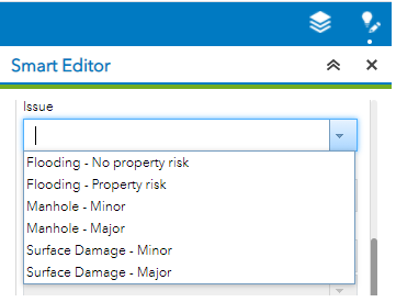

Hi,
I would like to use the Smart Editor Widget to populate a numeric value into another field based on what is selected in the 'Issue' dropdown pictured below.
The numeric value would then be inserted into the separate field 1, 2, 3 etc.

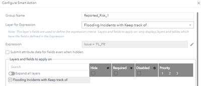

I thought I could use the new cool functionality within the widget and create a Smart Action with an expression whereby.
Flooding - No Property Risk would have a Reported Risk value of 2
Flooding - Property Risk would have a value of 1
 The selection from the dropdown would auto fill Reported Risk.
I have tried Attribute Actions > Preset also but you can't build an expression which is what I think I weed need to do in order to allocate the numeric value?
Thankyou

@CMcDonald This option is not supported in the Smart Editor widget.
What you are requesting may be done with Attribute rules. Please review the following article published on 3 January 2021: Introducing smart forms in ArcGIS Field Maps (esri.com)
Near the bottom of the article:
Attribute rules – are user-defined rules that can be used to automatically populate attributes, restrict invalid edits, and perform quality assurance checks on existing features when they are submitted. Attribute rules are coming to hosted feature services and to forms so that you can execute business logic in your form connected or offline.
Smart forms may provide the capabilities you require moving forward.
