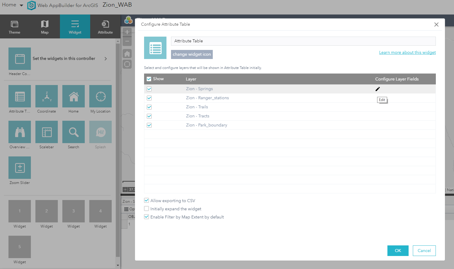

I am working on creating a web application. I have loaded up my main layer in a map and have configured a pop-up. I then went to look at the attribute table and its only showing the information that I have in the pop-up. I can select to show all columns in the table options but it doesn't stick. The table has over 90 attributes so they don't all need to be in the pop-up, but I would like for the user to be able to view all of the information about a feature if they want to in the table. This is going to be for internal use so a lot of the extra data is important to be able to view, just not in the pop-up. Any way to change this?

The Web App Builder attribute table widget lets you configure the fields in the attribute table independent of the pop-up. You will want to configure the pop-up in your web map with only the fields you want to see in the pop-up. Then once the web application is created with the Web App Builder just edit the configuration for your layer and display all fields.
Please let me know if this helps.

That worked perfectly! Thanks!
