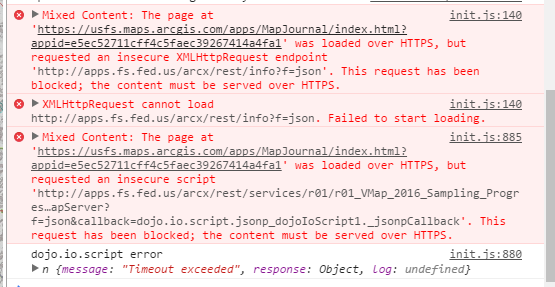

I ran it with the developer tools and there are 3 errors and 38 warnings. Here is a screen shot of the warnings:

Looks like there are some mixed content issues with the map.  The issue is that your app is loaded over https but there is some map content that is via http.  The problem layer seems to be this one:
http://apps.fs.fed.us/arcx/rest/services/r01/r01_VMap_2016_Sampling_Progres…apServer?f=json&callback...
Try editing your web map that the time aware app is based on and replace the layer that was added via http with the same layer but using https:
https://apps.fs.fed.us/arcx/rest/services/r01/r01_VMap_2016_Sampling_Progression/MapServer?f=json&ca...

That worked! Thanks much for your help!
