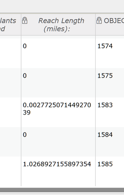

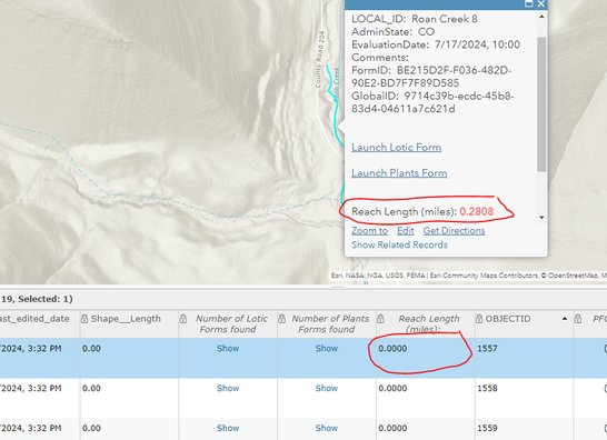

We are seeing this across multiple services and Arcade expressions.
Anyone know what is going on here?  Its been this way for some time now.  Not seeing this posted.
Simple expression LengthGeodetic($feature, 'miles')
Thanks

I'd be willing to guess that what you see in the attribute table is a different Arcade profile that doesn't have access to the geometry? Or there's something about the context of the table in particular that doesn't include the geometry.

@DougBrowningHow did you author this arcade expression? Did you create an attribute expression in the pop-up itself? This will not actually edit or update your data.
You have a few options here, but what I would suggest is first using the new field calculator in Map Viewer to automatically calculate the length using your expression there. This will update anything with a 0.000 value 🙂  to match what you see in the pop-up and saves a lot of time.
Then, moving forward I suggest using Forms and calculated expressions. This will actually calculate the values for you when you create or update features and you will see that reflected in the table.

It is just a simple expression in the viewer not any kind of calculated anything.  It has to be dynamic as it calcs from a 123 form.   String type shows more values than number which is strange.  Just random some are not 0.  Also no show button just a bunch of 0s even though the popup has a value.  We see this across several maps for a few years now.
